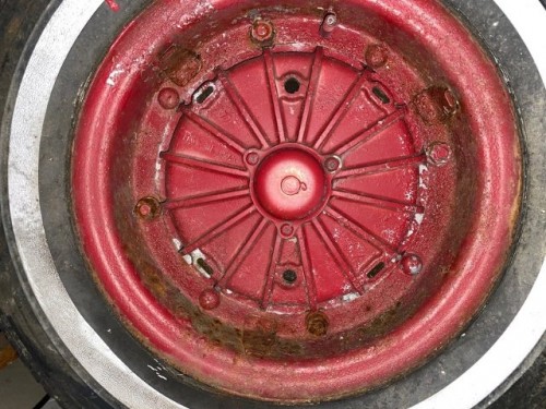

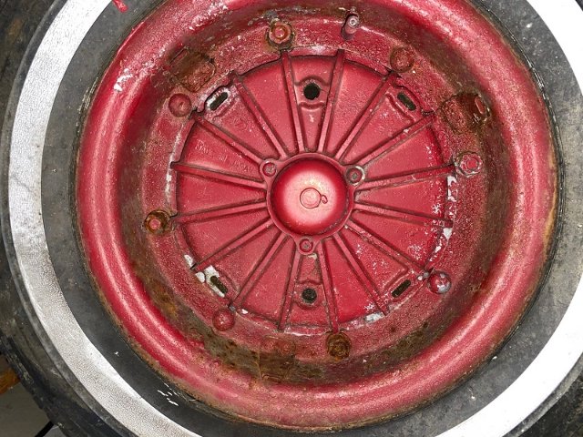

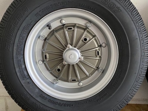

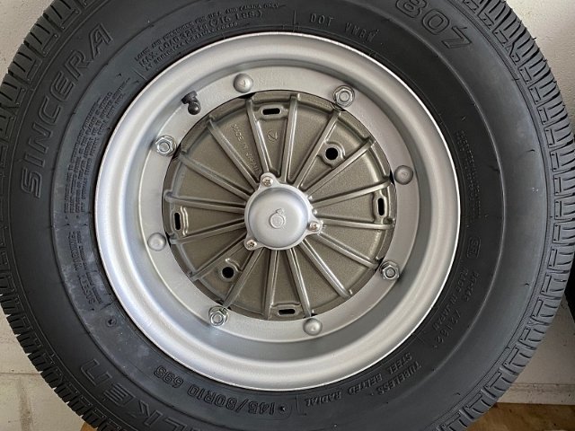

Hi books1, Sorry it's taken so long to reply to your warm welcome. I never saw the recent replies to my initial welcome post until today. Progress has been steady and mostly positive. I'm experienced with rebuilds and restorations and I've learned that to be successful you need to stay focused and try to do something, however small, every day. I've completed the major disassembly and started rebuilding the drivetrain. During lulls or while waiting for parts, I move to the bodywork. While my 360 is relatively rust free, it has a hundred dents, dings and previous bodges to remedy. I've gotten into the habit of completing the wheel restorations first with my projects so I have something finished to look at and keep me inspired. The 360 is no different so I've completed the wheels/tires. I preferred the look of the exposed drums but didn't care for the wheel cover clips so I removed them. Plus, I wanted the rears to match the front so I located two wheel centers on Jauce and fitted them to the rear drum. If you're curious how I attached them... I epoxied in small areas like the front drums then tapped them out for the new centers. Anyway, lots more going on so I'll post more in the appropriate subject columns as I progress. As a matter of fact, I'm experiencing a very perplexing gearbox issue that I'll post about later so please have a read and let me know what you think! Jeff

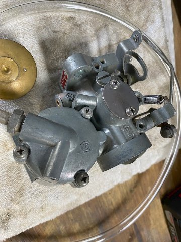

You are missing several important parts of the carburetor!
See P. 16 thru 19 in the BOOK OF REPRINTS and read the article in a Newsletter
maybe a year old on HOW NOT TO RUIN YOUR CARBURETOR.
You can't just go out and buy a new one :shock:

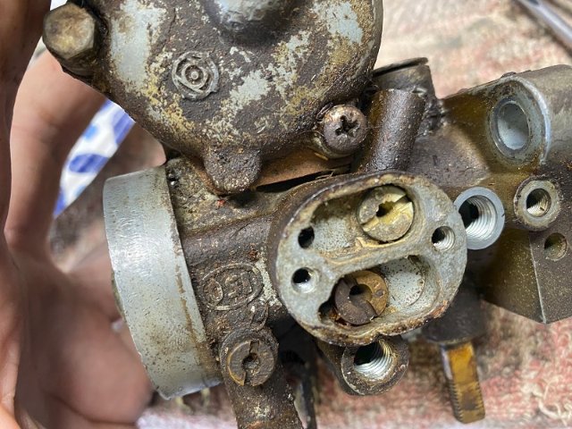

Hi Ed, I don't believe I'm missing any carb parts. I included the carb pics just to show my fellow members that I'm trying to be pretty thorough with the cleaning portion of my project. That pic was taken after cleaning and then just loosely reassembled while awaiting the rebuild kit. I've had the carb apart, cleaned it and rebuilt it with all new jets, gaskets, etc. It's already been re-installed and works perfectly after a slight adjustment to the float level. Thanks for keeping an eye on me though! Jeff
