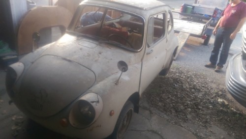

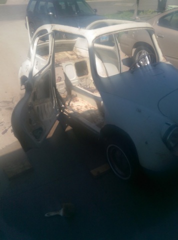

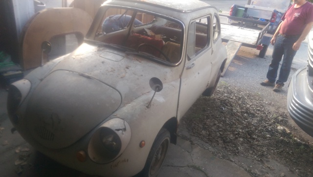

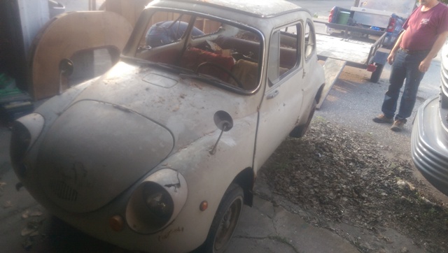

Hey all! I picked up a '70 deluxe last week that has sat since '79. It needs a complete restoration and i dont have the engine/transmission yet but i love it! His name is Pablo (hence LittlePicasso). The first picture is from when i pulled it out of the storage building, and the second is today after i've pretty much pulled it apart. He's in rough shape after some kids a few years ago broke all the glass and kicked in the body panels, and he'll need a lot of parts, but im excited for the journey!

Welcome!! :D You got the pics in early :shock: That looks like a pretty original sedan, Inside Pics please :wink: :oops: Already apart :?

I don't have any interior pics currently, but it's down to the metal, seats need to be redone and the floorboards are rusted through
