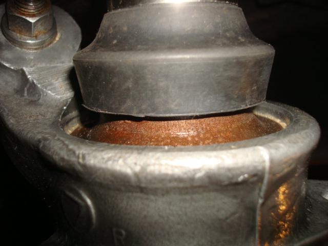

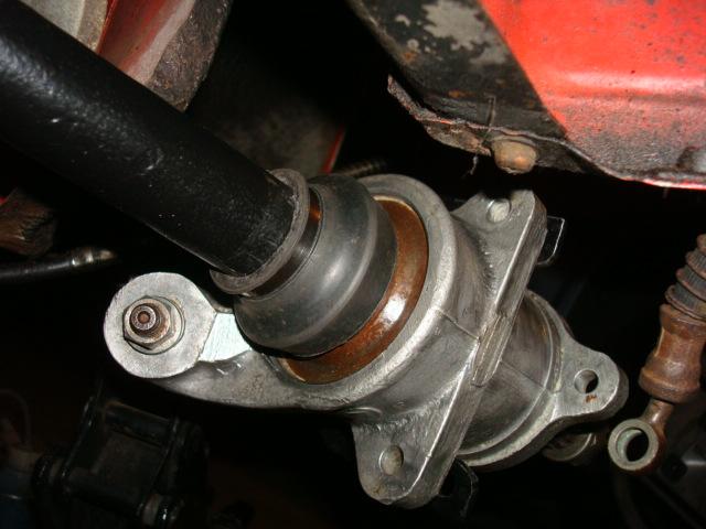

Also should I put in those Axle seals and fan seal I saw posted? I freed up the E-brake and all the other cables. Does anyone make those E-brake
cables? Also got new boots and those small rubber collars that goes on the back side of the axle bearing housing. On that part if I slide it
over that metal flange on the bearing housing, it squeals as I turn the axle. Should I grease it or just not push it up on the flange - see pic.

Welcome! Another Young! I really have no guidance to give on that. I'd say grease it but I have no experience with this part. As I understand it the metal part it is going up against is stationary, is that correct? The rubber pc is somewhat a slinger and a seal. If anything gets on the rubber part it slings it off and it doesn't get under the lip and into the bearings. My 2 cents. You didn't happen to get any extra Young parts like a gear shift knob.

Thanks for the replies. I probably Q-Tip a little grease on that flange end and see what happens.
